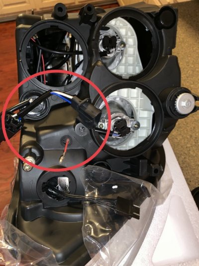

I installed these last night but cannot get the turn signals to work. After I first start the truck they will work for a couple of flashes and then they quit. I have the hid bulbs and ballast. Do I need a resistor?
Without programming, I believe these should have resistors for the turn signals and parking lights. I used AlfaOBD to enable LED front turns and parking lights and that solved everything. Call alpharex and ask them about it. I talked to a guy from there for a while and they said they were working on it, so they may have a solution they could send you.

Thanks, Jimmy. I sent them an email this morning. I'll be the first to admit, wiring is not my forte at all. What does the gray wire go to?
Does yours have something different?
If you're talking about the grey wire on the box unit that goes to any 12v that is only hot when the key is turned. I used a fuse tap and went to fuse 90/91 changed the fuse to the ignition I believe 91 config

Does anyone that has the HID kit know if they have led resistors in line? I’m starting to think that may be the problem.
The HID low beam bulbs would have nothing to do with the turn signal issue you described. I had the same symptoms you described with the turn signals and I solved it by changing the BCM settings.
Looks like your options are contact modifystreet/alpharex for a harness with resistors to solve the turn/park issue, buy some resistors like https://www.amazon.com/dp/B00DCULNXS/ref=cm_sw_r_cp_api_i_I17PCbJ7YW04D
Or get alphaobd or find someone local with alphaobd and change your turm/park lamps settings to led.
