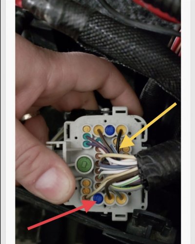

Since we have 2500s, our DRL wire locations are different than his 1500. He will use pin 8 and pin 23, whereas we use pin 5 and pin 29. The bad thing about that is, pin 8 happens to be the bigger female terminal.
@rotwiler, here is a good picture of the front end connector under the fuse box that 1500ram12 is referencing. It is the back of the connector half that has the big disconnect lever on it- U9ylRK4.jpg
The red arrow is where you would insert the terminal for the driver side DRL. The yellow arrow is where you would insert the passenger side DRL wire. Since these terminals are hard to find without having to buy a bunch at one time, I would suggest you get a hold of @Mpgrimm2 and he can hook you up with two 8” lengths of wire with those terminals and wire seals on the end. You also need to confirm first that the mating half of that connector (the one with the male pins) already has the wires going into it at those two locations that would plug into the terminals you are adding.
