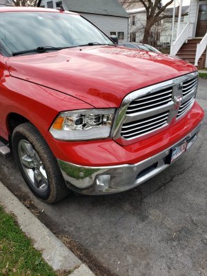

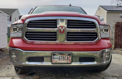

Mine are in and I THINK I got them adjusted down to keep from blinding everyone (passenger side was VERY high). The DRL wiring was far easier than I thought: you can actually see the back half of the harness plug from inside the driver side headlamp cavity. MPGrimm2's harness jumpers were just the ticket! And I too am running the Hikari Ultra LED H7 bulbs in all four projectors. I haven't yet driven at night though- yesterday was a Harley day after drill!
Here's a few pics of the Chrome version of these lights:

My passenger side was way high also.
