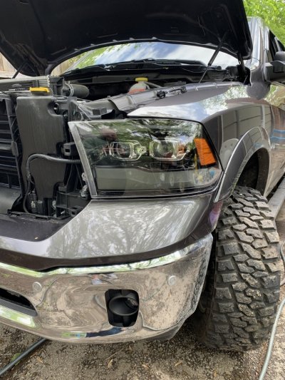

Not mine:
That's it i'm sold, sequential and everything I wanted. These are only available on ebay right now correct? Amazon still 1st gen?
I was into the morimoto model until all the problems and the high price, these look amazing and with some Hikari's are the perfect setup.
