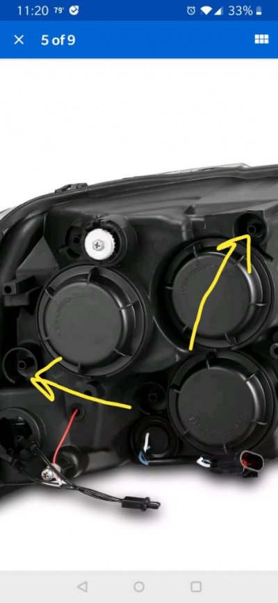

See pics below..78b054bd3a89ac9745844db77bfaac8e.jpg5f34e82509a3b4b9d8526f9b69d7c8e1.jpg

I think those are vents. Appear to be in about the same location as oem if I remember right
On the current version you and I have of the modify street lights they are blank, in the picture it somewhat looks like screws..that and the fact it says beam adjustable...gonna have to wait till someone has them..already 85 sold, almost gone! Had I seen them I may have opted for them there has to be a reason they are 100$ more than the standard ones...other than the switchbacks...

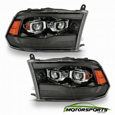

looks like the new V2 are up on ebay
They have smoked upper/lower lights and switchback led
Those are modifystreet headlights, so most likely are the v2. Geesh, now I want them, I see it has dual white drl too! Is odd though, in add shows the blacked out and normal ones, if only the side marker was silver or tinted, it would be ideal.
Yeah, Alpha confirmed this is G2. I was really hoping for cleared instead of amber side marker.
Have not asked if they are making them in the other finishes (i.e. chrome or jet black)

Like 1500ram12 said, those are the vents. Mine have rubber caps in there that have pieces of mesh inside to absorb moisture.

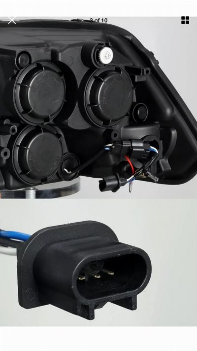

Install is straight forward. Blue/white/black harness goes to your trucks headlight harness. The 3157 style bulb base coming out of the headlight gets plugged into your truck's turn signal socket, like the bulb you'll remove. The harness that comes with the headlights is for the drl's. The 2 red wires in the harness connect to the corresponding red wire coming out of each headlight. On the drl module end you'll have a 12v positive and ground connection. The Grey wire goes to a keyed on fuse in the fuse box in front of the battery.
Brandon Tanner
Apr 24, 2019
West end NC
There is two Male connectors to fit the female the two females on the truck right? I have the quad lights.
And the back of the housing
It's weird that it appears to only be one connection for the headlights and turn/park lamps . I'd definitely like to the full harness, connection points on harness/housing if different from the pictures I found and instructions.
Edit : pulled this from Amazon in the questions modifystreet had a link
Sent from my iPhone using Tapatalk Pro[/QUOTE]

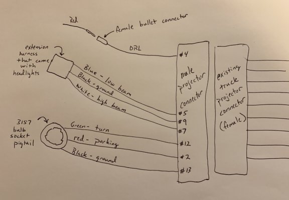

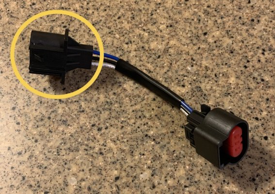

For those that have factory projectors that want these, here’s an easy conversion harness you can make. The headlights already come with one third of the parts- this little extension harness (circled)- kmBXyK7.jpg
Here’s the 3157 bulb socket pigtails that goes into the socket holes on the new lights- https://www.amazon.com/iJDMTOY-Pre-Wired-Harness-Repair-Replacement/dp/B01GP6B9WA/ref=mp_s_a_1_fkmrnull_1?keywords=iJDMTOY+(2)+3156+3157+Pre-Wired+Harness+Sockets+For+Repair,+Replacement,+Install+LED+Bulbs+For+Turn+Signal+Lights,+DRL+Lamps+or+Brake/Tail+Lights&qid=1553571390&s=gateway&sr=8-1-fkmrnull
And here’s the male projector harness mating connector (2 sets)(thanks for the link @1500ram12)- https://www.amazon.com/headlights-1J0973837-lamp-socket-Headlight-connector/dp/B07LD6C2R1?th=1&psc=1
And you’ll need two 10” lengths of 18awg wire with two female bullet connectors for the DRL wire (not sure what size, I had some red ones laying around that fit).
Then just crimp the appropriate male projector connector terminals on the ends of the wires (pay attention because some wires get small terminals and some get the large terminals), and insert them into the correct numbered pin positions. g840zqD.jpg
Note: in order for the DRLs to function with this wiring method, the dedicated DRLs need to be enabled with the alfaobd. Otherwise, don’t pin the red wire into the projector connector, and use a relay harness to trigger them.
