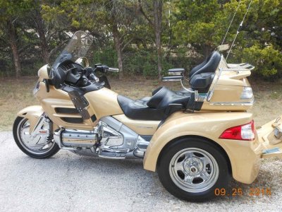

I personally have never filled an oil filter 1st on any car/truck. But since the Hemi is vertical, not an issue. However, on my flat bore V6 Honda 1833 CC MC engine, it is highly recommended to fill filter till saturation and then at least 1/2 way up. Due to the flat 6 cylinder, U end up with oil starvation on a newly changed oil/filter job (takes 10 seconds when filter dry, at least, till U build oil pressure), worst thing U can do to a bike motor. I just did my Honda the other day, and the filter is not vertical, it is horizontal. Just lost a few drops. Just do not fill the filter to the very top.
