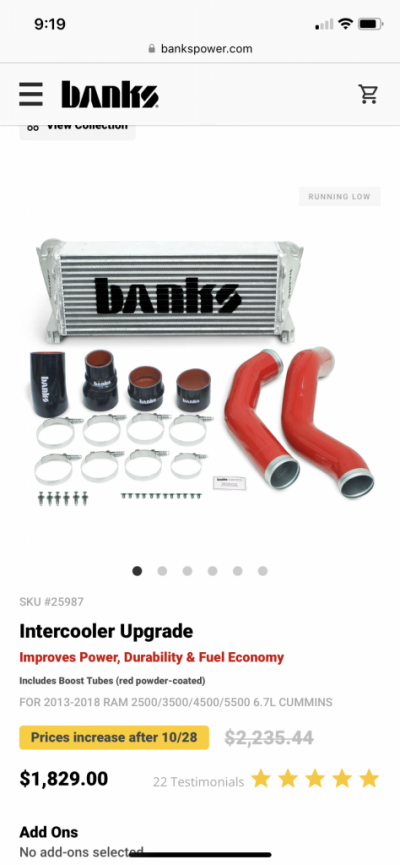

Crash said it perfectly. All I’ll add is if you want “colder” air you can upgrade the intercooler but is the cost worth it at that point? Unless you are tuned and racing is it beneficial? You won’t see much change by any one part for what you have. I’m all for boosting your power up but cost to benefit ratio is a huge factor for me. The return on a CAI in your application would have no positives for your engine. The factory setup is an active setup. One opening is in the fender and the other is open by the wheel well. The truck uses a temp sensor and humidity sensor to calculate which opening has colder denser air and will switch. A better intercooler without other engine upgrades is negligible at best since they are sized to the application already. Banks intercooler kit is 1829$ and claims 27hp and 51ft lbs but lists indirectly in fine print that tuning may be required to achieve that
