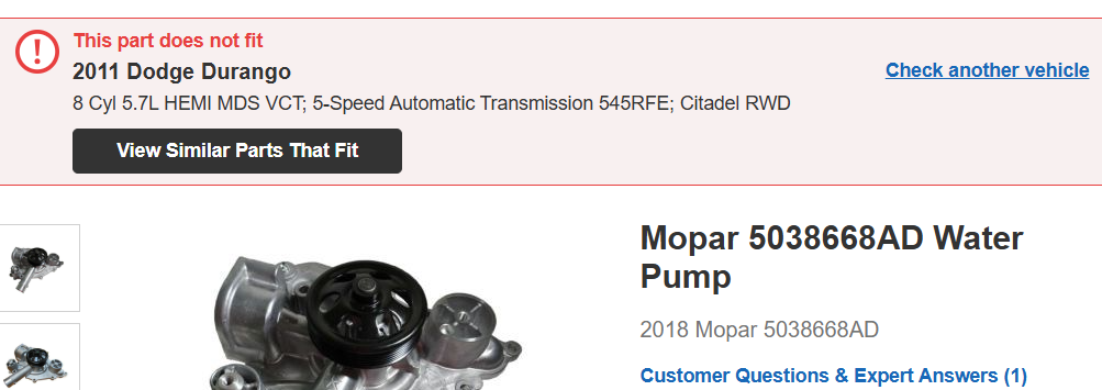

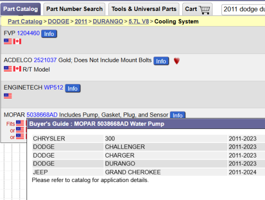

A couple months ago I replaced the water pump on my wifes 2011 Durango 5.7 Hemi, with this Mopar unit from Rock Auto. Mopar 5038668AD:
Here's what Mopar Parts Giant has to say about that water pump, as to it's fitment on the 2011 Durango 5.7
