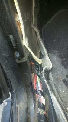

i pried up the kick plate beside the driver on the floor. is this bundle of wires the speaker wires? or something else? and if they are which colour is the front speaker wires to tie into for my amplifier for my sub?
any help would be great!20180201_142236_resized.jpg 20180201_142242_resized.jpg

and...are the front left door speaker wires Grey/Yellow & Grey/Violet? I have the wiring diagram but not 100% sure I've got this correct.
lastly, is there any difference tapping into the front speaker wires vs the back door speaker wires?

Your going to fry your BCM or shoot out an air bag if your not careful. Just go directly to behind the radio.

oh. well I was told that was the best place to tap into the speaker wires...and if I didn't have to take out the head unit which is a pain in the ass id' rather not. just looking for help/options.

Pretty sure you should tap into the rear speakers... I don't think you will get a full range input tapping into the fronts. At least that's what I've read in other threads.

The rears in Chrsylers are known to be attenuated at higher volumes, that is why it is not suggested to go there. It literally takes 5 minutes to get the radio out, it is more difficult to find the speaker wires in the main harness then to run it to the radio. You know exactly what your getting and have no concerns. Plus stripping twisted pair wires in a main harness can be a PITA for pros, doing it with no experience is going to be worse.

The speaker wires in the b panel are for the rear doors. Based on what Adrian said you wouldn't want to tap there. The front speaker wiring is NOT in the b panel at all, only the rear door speaker wire is in there.
With that said the speaker wires were twisted together. I snipped them and untwisted about 4-6 inches for slack. I soldered back together with my line input wires in the solder joint and then heat shrink over it all. It has been about 7 months since I installed, but the rear speaker colors were grey/green stripe on the right side and dark green/grey stripe on the left side. I turned up my radio and used a voltmeter to determine + and - correctly. I cannot remember which was which at this point.
