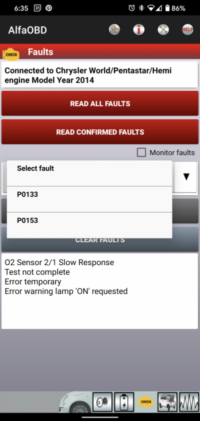

I did throw 2 codes, I ordered 2 more O2 sensor extensions assuming I was fouling the sensors before I read the codes.
The code Read "O2 Sensor 1/1 Slow Response" & "O2 Sensor 2/1 Slow Response"
I cleared the codes but still have the surge.

1/1 and 2/1 O2 slow response means the oxygen sensors are not switching like they are supposed to. When the sensor gets like this the commanded AFR can't be reached in a timely manner and the engine can run bad.

With the slow response DTC's I would replace the upstream oxygen sensors with Mopar units.
I don't use AlfaOBD so I'm not sure if you can see live data or the adaptive memory and fuel trims.
