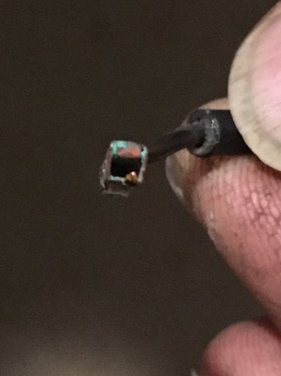

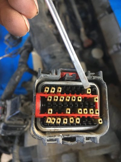

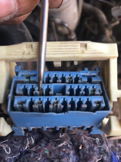

Hey guys, I'm not sure if this will help cure your concern but I ran into an issue with my 2012 2500 5.7 over the weekend relating to the ASD and thought I would share. I bought the truck used and quickly learned that some individuals should not pick up tools or even consider working on electronic stuff. Anyway, with that said, here goes. I noticed that someone had overlaid the Brown/Black wire that goes from ECM to C103 (I think that's the connector in front of the battery). After a bit of searching, and to make a long story short, I found the pin that connects to the TIPM and more specifically, the ASD relay was extremely corroded as well as bent/damaged. I haven't repaired it yet, as I need to purchase parts in order to do so. Might be worth checking the connections under your TIPM for this or a similar concern. Hope this helps.
