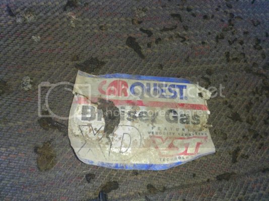

this is a pic of the tag that was on this front shock
DSC_0083_zps75cb5c5b.jpg"]DSC_0083_zps75cb5c5b.jpg[/URL]
and this is the shock the tag was attached to
DSC_0081_zpsbf479a34.jpg"]DSC_0081_zpsbf479a34.jpg[/URL]

I believe those are called control arms or something like that (someone fix it if i'm wrong) and I wouldn't be interested in used shocks (unless ur just referring to the model of shock) personally, don't always know how much life is left in them plus you can get OEM quality for not very much from somewhere like Oreillys
Edit: Shock across front is a steering stabilizer, not really a shock as it doesn't spring back instead it reduces vibration, can run without one but that is not recommended

Secondly, Skyjacker shockers are "eh" by a lot of folks. Control arms and their accessories might not be a bad little upgrade if it's not too much work getting them out.
And don't buy used shocks. lol Might be able to use that steering stabilizer you found there though. Those don't wear out as quick as shocks do. (I've got my stocker from 98 on my truck)

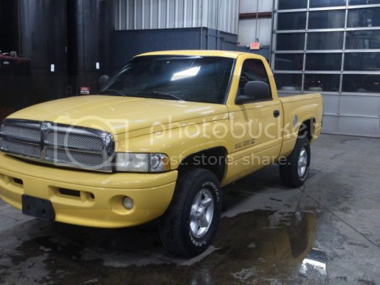

nah im not too interested in the lift but if anyone is just pm me and we can talk to see if i can get it for you.
how does it look as far as me getting 33's under my truck? does it look possible?

I may be interested in the lift if the price and ship is right :) I have a '00 single cab short bed and have run 33/12.5/15s with only slight rub on full left lock... however I also desperately need an alignment so that may have been my rubbing issue. hope this helps. Also i have 250k on the original suspension including shocks so they are probably sagging slightly ;)
