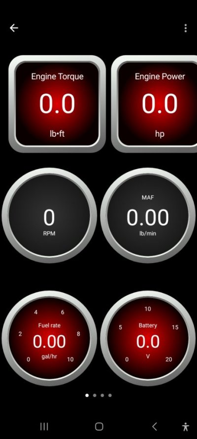

Thanks Skates for the answer and Dean for the mx+ Link OBD reader idea! Flip-er, good question: I am purchasing a back-up "generator" (a 40A DC-to-DC battery charger) to be powered by the RAM's battery/alternator in order to charge the Lithium Ions in my RV, but at almost a gallon an hour, it is only practical for dire emergencies!
