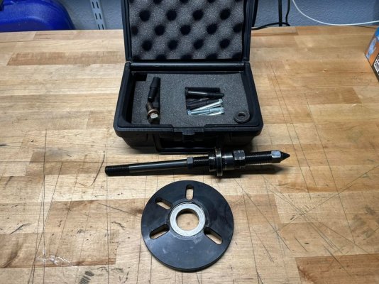

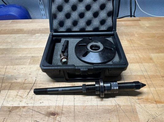

In case all you guys need the info on the tool required for the ATI balancer. I had to change my front seal because of my 13PSI is blowing the seals out. I have no idea why the ATI requires like a .005” interference fit, it is so tight! The Proform puller is identical to the ATI puller the Hemi adapter bolts even for it, so save your money Folks!
Check out this page from Summit Racing https://www.summitracing.com/parts/ati-918999
Check out this page from Summit Racing https://www.summitracing.com/parts/ati-918999h
Check out this page from Summit Racing https://www.summitracing.com/parts/pro-66514

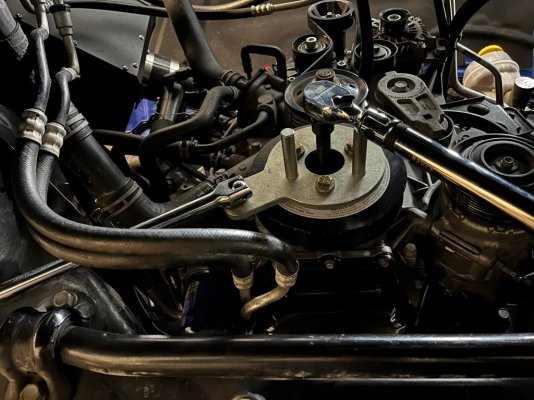

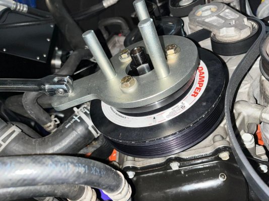

I also used a Mopar Ram Hemi balancer tool that I drilled for the ATI to aid in holding it.
https://www.moparessentialtools.com/item-detail.aspx...
Check out this page from Summit Racing https://www.summitracing.com/parts/ati-918999hc

This is not the ATI puller but I believe its the same one for a fraction of the price, and very reputable shops says they actually put the hub in an oven for a while before installing it, I would not chance it with an impact. I actually broke the factory bolt off in the crank of my brand new 6.4 when I was trying to use to install the ATI, took me forever to get it out.

The link is still good, it’s the Proform puller at Summit, I also attached the ATI puller to show the price difference.

I posted the specific bolt link for the Hemi, it was super sketchy trusting it to pull the ATI on, heating the hub is a really good idea considering the resistance fit tolerances.
