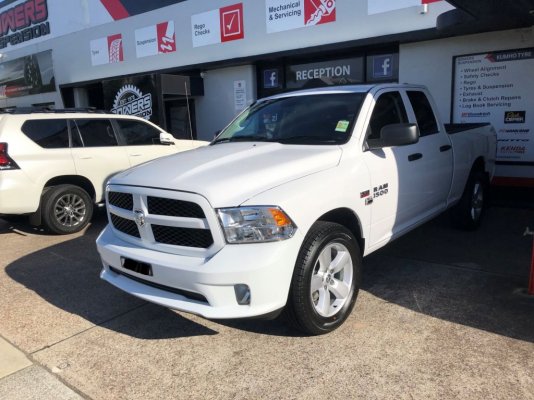

Here are some more stuff. The first photo is the identical Ram to what I'll be getting delivered, that has been lifted 2-3", fitted with the same American Outlaw Legacy 18x9 wheels and what are I believe 295/70/18 tyres.
Second photo and the link below is the front winch bar I have ordered. Takes a 12500lb winch, rego plate has a hinged bracket to hide the rope and head. It looks ugly in black in teh link but looks far nicer in white as per the Crew Cab photo.

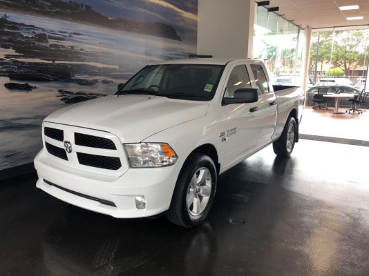

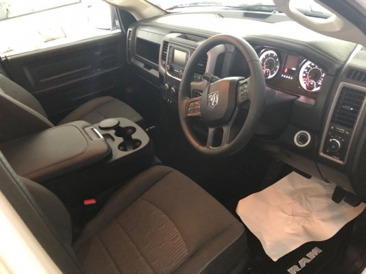

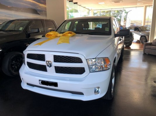

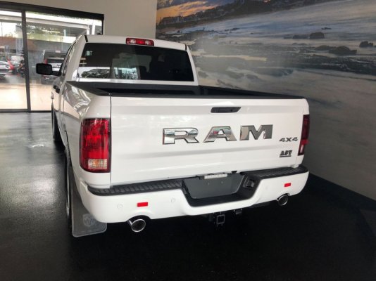

My new Ram is in the showroom. Picking it up on Friday, straight to get 2" suspension upgrade with rear airbags and the 18x9 American Outlaw rims and tyres fitted. So these are the "before" photos.
Ram in showroom 1.JPGRam in showroom 2.JPGRam in showroom 3.JPGRam in showroom 4.JPG

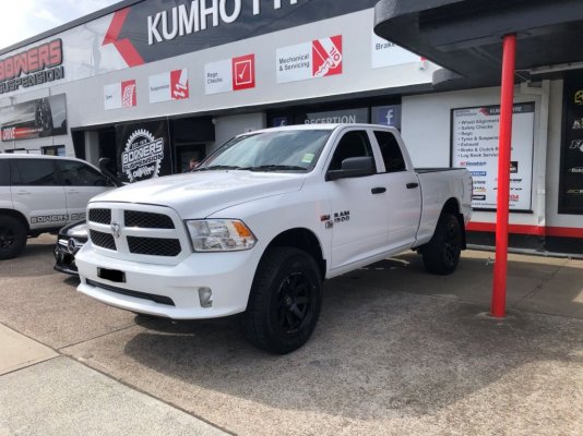

Here it is getting picked up last Friday:
Dropped off for suspension and tyres/wheels 10 minutes away:
Same afternoon:
The new wheels are the same offset as the originals (18P) but are 18x9 rather than the original 20x8. New tyres are 295/70/18, originals are 275/60/20.
Supposed to be a 2" lift, although the front has come up 3" as it has springs to suit a lightweight bar and winch.
In theory new tyres are 38mm in OD larger. I put it on a chassis dyno today to check the speedo, it is dead spot on at 60, 80, 100 and 110km/h, took a video of the dyno readout at the same time the km/h were displayed on the dash.
Only problem now is calcs say that the wheels are only 1/2" either side of centre wider than the originals (same 18P offset), and the tyres are 10mm wider either side of centre (295 vs 275). However the passenger (LHS) front tyre tread is dead flush with the guard/fender. The driver side (RHS), the tyre tread sticks out about 10mm (3/8"). Not sure why, going to check to make sure I don't have a different offset wheel on it somehow.
However, standard Laramie wheel arch flares will fix it and I'm happy just to run them on the front. Does anyone know if those in the attached link (Ebay auction is only for one corner, however it shows the pictures of the whole lot), do they attach using the screws under the lip with some tape around the perimeter? I don't want to drill holes.

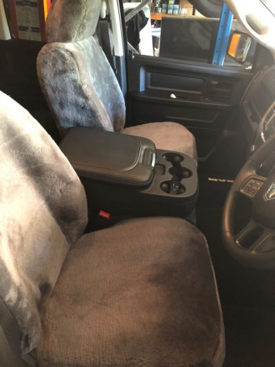

I had these made and fitted a few days ago, full Sheepskin covers:

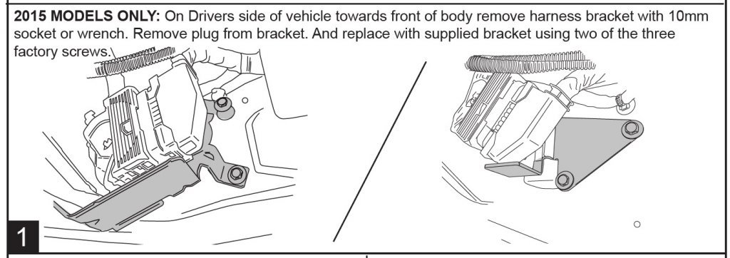

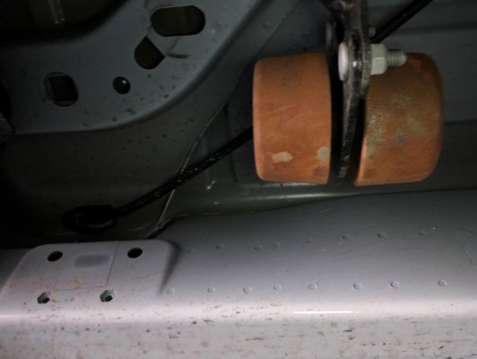

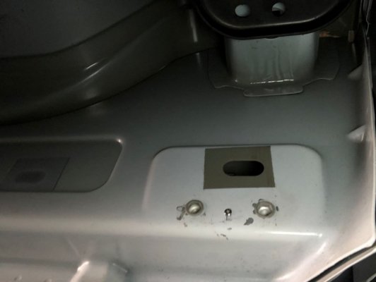

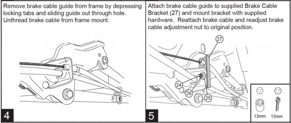

I've also started working on the AMP Research power steps installation. For an Australian install on a 4th gen 1500/2500/3500 you have to buy the hardwired versions (part number 75138-01A REV B) as the Plug and Play version won't work properly on a RHD vehicle.
So I have been doing the bits that I can do a bit at a time without committing to a full install on the day. The front mount already has a strengthening plate, the rear I had to remove the factory riv-nuts and install the supplied strengthening plates and new riv-nuts. Wasn't too careful with the zinc-rich paint I used to cover the hole I had to drill (for the rivet) or where I'd chipped the paint removing the factory riv-nuts.
Front (you can see the welded nuts and plate there already, I still have to remove the tie-down point you can see in the image):
Rear, strengthening plate behind (rivet in centre holds it in place) plus the new riv-nuts:
I didn't take photos of the relocated handbrake cable or the underbody plug on the LH side of the vehicle, but here are shots from the installation manual:
Plan to do the other bits where I can do and stop, like run the harness, mount the control module, attach to the battery, splice to the cabin harness door-open wires and install the under-sill step lights. Plus cut the steps down to the right length for the Quad cab. Then when I get a clear, cool day I can mount the motors and fit the steps in a short period.

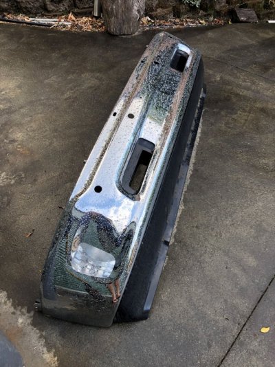

I picked up a new Laramie bar complete locally. It was raining so picture not so good:
I managed to order a new top plastic piece from the USA. Just have to get the few other unique bits that aren't on my Express, then I'll order the Vice Designs hidden winch setup and modify this bar. I'm going to get it painted white and put some dummy parking sensors in the holes.

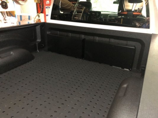

One of these turned up today:
I'll fit it and a twin piston ARB compressor behind the battery.
Here are two battery boxes mounted at the front of the tub. One will hold a 175Ah Lithium dual BMS that can give me 150A continuous, and an Enerdrive 40A dcdc. The other will have a 2000W Inverter fitted in it.
Items as per below links:
dcdc: https://enerdrive.com.au/product/12v-40a-dc2dc-battery-charger/
Inverter: https://enerdrive.com.au/product/ep...wave-inverter-with-ac-transfer-safety-switch/
175Ah battery: https://www.aussiebatteries.com.au/atlas-175ah-12v-double-bms-prismatic-lithium-batte
