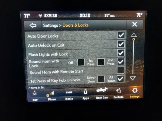

My '21 has the auto door lock option in the Uconnect radio settings but, that's not the same as using the FOB or door buttons. AFAIK, both of those operations are considered a manual locking action.
