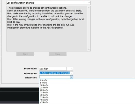

I don't have that feature on my truck but I could offer a wild-ass guess or something to explore, depending on your level of motivation.
If you can locate someone in your area with the AlfaOBD app and a security bypass cable compatible with your truck, there is a setting for Auto high beam 'on' threshold.
I realize this menu item name begins with 2014 but I found this in the 2022 BCM options, keep reading. :cool:
I would guess this option would still apply to your vehicle. Digital machines/computers/our trucks and the like tend to hiccup unexpectedly and reconfigure themselves.
It would appear that your truck's auto high beam 'on' threshold is now at 25 kph/15 mph.
With ALfaOBD you could change this setting to 0 kph if you prefer.
I'm not familiar with the dealership's ability to modify these options. They may or may not have access. If not, AlfaOBD might be a solution.
If you would prefer, you could send a PM to @RamCares and ask them to investigate if a dealer has the ability to change this option or not.
RamCares would also be able to coordinate the adjustment with a dealer, saving you the grief, if the dealer is capable of making this change.
And, welcome to Ram Forum. :cool:
