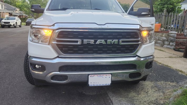

Are your front turn signals LED?
My truck uses the signal lights for DRLs, and the LED are very bright.
When I see oncoming Ram trucks using signal lights as DRLs, they appear to stand out better than low beam headlights in bright sunlight, AFAIC.
I drive primarily in rural areas. The appearance of signal lights used as DRLs may not be as apparent for city driving. Try them out for yourself and decide.
YMMV
Yes, switchbacks, however, I cannot find a good fit for my truck that has a bright forward facing lens
It's weird but not even Lasfit has a bright white switchback.... all bulbs I found all have caps on them with side lights only... also my socket is a certain kind that requires a CK Socket
