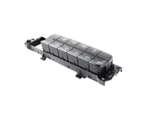

I am trying to get an auxiliary switch panel with the five aux switches working in my 2013 Tradesman.

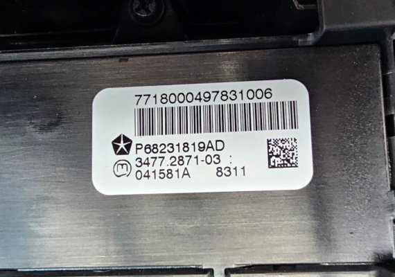

I have panel number P68231819AD in my truck that is not working with my truck.
If anyone has one working in a 2013 please share the part number with me.
Thanks for any help with this

IIRC, the option has to be turned on. There are like 5-6 different options

Correct. You have to get the sales codes added for each of the functions that aren't currently present. Assuming the modules are there that the switches control.

My truck is a 1500, are you talking about the 2500?
I am adding this with a relay/fuse block to control lights and a couple other things I am adding.

The OEM panel type.
I've read there are different numbered panels. Mine has the traction control and tow/haul only.
Some will work I've read but I haven't seen numbers anywhere of the panels that do.

That a 2015-18 panel PN... See here
If it's like the heated seat & switch panel upgrades, 2013 (& maybe 14) needs a specific unique PN switch panel. Reach out to Benny @AllMoparParts.com for confirmation (if you find the vin of a 2013 2500 with aux switches, that will help also)

Today I received the new auxiliary switch panel and tried in the truck.
It doesn't work.
So I took the original panel and put it on the original wiring harness only to have nothing work again.
So, which fuse should I be looking for to change or see if it is good or bad? Or is there a relay maybe?
Any help will be appreciated.
Thanks in advance.

Anyone know what fuse or fuses are for the traction control and tow / haul?
