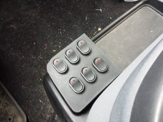

Sounds like you'll have to go the aftermarket route and figure out a bracket/mounting place. I decided since the tray in front of the jump seat was unused, it'd be a perfect spot for a switch mount:
(unfinished)
