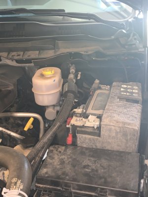

Take a pic of your engine bay near the drivers side close to the firewall for us to see, that will help us help you.

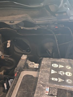

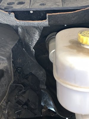

Here are the pics. Thanks

From what I gathered on rambodybuilder website you either have to order the truck with the AUX switches which means it will have that connector and the switches. Or an option for upfitter ready which will have just the connector. The wires are actually in the harness but they are blunt cut unless you have one of these options. If you feel the big harness coming out of the firewall on the drivers side you find a big hump in it. The blunt cut wires for the AUX switches are in that hump. They are cut off, folded back against the harness and wrapped to form that hump. There is a kit for installing the connector to the blunt cut wires. The schematic for this harness is on rambodybuilder.

Thank you. I do have a big clump of wires taped together between my battery and my firewall that looks like what you are describing. Would you know why they would put Aux switches in a pick up but not have the connectors already wired? Thanks again.
