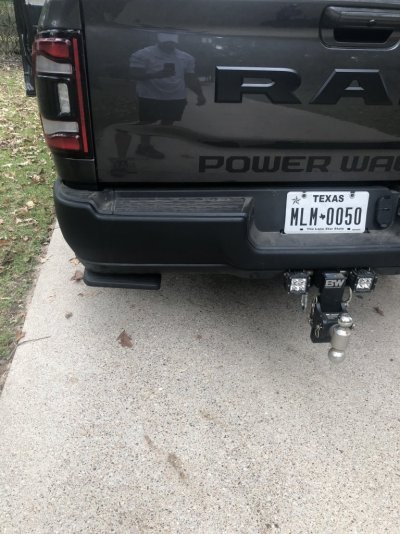

I have to ride with it low when not in use so the bumper sensors don’t go off.
