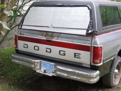

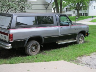

My trucks been sitting for about 5 years now , just havn't been using it , went out this spring ready to do some maintenance on it as I going to be doing some projects that my workhorse will be needed for. I started it every so often while it sat and it always started till this spring . ..
Spray some starting fluid in the TB and she would fire right off . . the fuel pump gave up as did the battery.

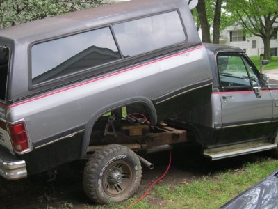

So I didn't lift the side of the bed , jacking up the front worked out ok , kept using longer 2x4's & my floor jack in stages , an engine crane would have been less time consuming. I was able to lift it high enough to get the fuel pump in and out easily. New battery & pump and she's running but now spraying fuel from the fuel line. I ordered a fuel line from Rock Auto , complete line kit , pre-bent with fittings.
