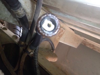

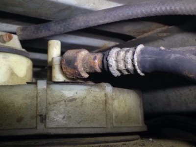

It's this guy that I'm worried about. Then theirs a plastic connector on the hose behind it. I was thinking about busting the little nipples off the old pump then worrying about them after I get the tank out. And for the fill line just try to take it off at the tank?

you are best to get the tank onto the ground and then pull them off. from my experience that connector does not look right for these vehicles. should be plastic connector connecting to the sending and i think the line to the frame is also suppose to be some sort of plastic or at least it is usually when stock

Yeah it's probably a replacement line. I believe the connector behind it looks like that one.

i wouldn't worry about it too much. if you drop the tank and can disconnect it at the other end so you can get the tank out it might make the line easier to remove from the sending when working on it while not under the truck especially if that is the type of connector i think it is. i think you will need tools like this to remove that connector if it is the type i think it might be and even then it is a real pain in the ass.
A/C and Fuel Line Disconnect Tool | Princess Auto
also if you do damage that connector i don't think it is a big deal i am not 100% sure which one that is but i think they should have replacements and if all else fails you could probably get away with fuel line and hose clamps.

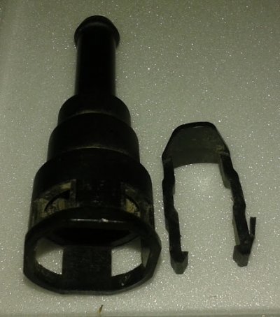

Hey Crazy or any one really. I got the whole pump changed except this fitting. I broke it off the old pump just to speed things up and now I can't get it out to attach the hose to the new pump. I bought one of those tools you linked but the piece inside the fitting isn't perfectly round. Anyone got an idea or should I just rip the hose off the truck and replace it.

i hate to say it but you may end up needing to replace the fitting. you could try drilling the plastic out but it will still most likely damage the seal.

I just did this on my 1991 W150. I decided to NOT drop the tank because right before the pump went south, I filled the damn tank! Soo, I did the truck bed tilt way. Worked out very easy and was a breeze. Those connectors are easy to get off safely if you are careful if you have room. And you have plenty if you tilt the bed. If you want me to walk you thru the tilt bed how too, let me know here and I'll do it happily. But generally, there is a clip in the connector that is or used to be white plastic, it is probably yellowed by now. When you have the bed u-p and out of the way before you do anything else pinch the clip with a tiny slim needle nose plyer and just pull the hose straight off.
Don't force anything and you'll get it.

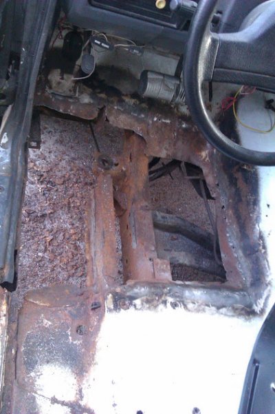

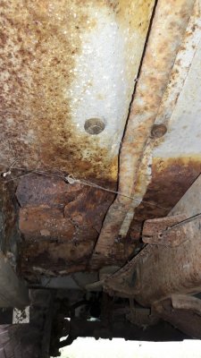

Ok as I was under the truck I took a better look at my drivers floor rot , seems to be way worse than I originally thought , it looks pretty bad really thinking about sending her down the road at this point.

that really doesn't look too bad to me. looks like the front cab support need to be fixed along with a floor pan but nothing major. i would still say that still has lots of life in it as is as long as the truck is not winter driven and maybe a few more years if it is winter driven. you will know when the front mount starts failing because the front of the cab will start sinking. i have fixed worse on my 93 and my 81 is still worse than yours. still drive it all the time with no issue

Mine is from the edge of the rocker to the frame rail , that out board support is whats rotten. Is that a part I can get or would it have to be fabbed ? You have a go to source for parts ?
