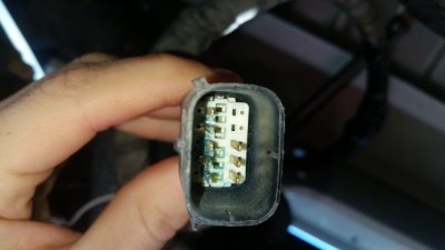

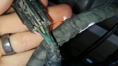

While under the back of the truck yesterday extending the license plate light wiring I found a harness connector and had no idea what connected to it. This morning while trying to find a harness connector for the p/s license plate light I stumbled upon the unknown connector that I have and found out that it goes to the radio for a back up camera. I can find a camera for a decent price, I just can't find the harness that is long enough to go from the camera through the tailgate and into that connector. Appears to be around four to five feet that is needed.
Any help would be great.

If you have the wiring going to the back of the truck you can purchase the factory jumper harness and tail gate camera handle. You can contact Benbybst allmoparparts.com. They are in the vendor section on the forum. You will need the 5" RA2 or higher radio in order for the camera to display on the radio screen plus enable the proper codes in you BCM. You can either have the dealer enable the codes or do it yourself with the alfa OBD tool.

This is the plug in. Not sure if it will help.
Went to allmoparparts.com and could find the jumper harness. I tried Google too.
