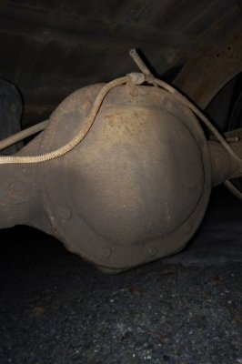

EDIT: Or if you find me a full drum with backing plate assembly, that works too. I need new drums anyway. Here is a picture of my rear diff. There are ten bolts on the cover... can you guys confirm from this the exact drums and backing plates it requires? Want to be 100% sure before I ever buy them.

i am pretty sure the backing plates are identical on both 8.25 and 9.25 axles. the drums and all the brake parts are the same between the 2 axles. you got the 8.25 axle
