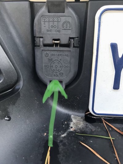

Tell me if you see any issues with the wiring of the backup camera?

I would have the shop just test with another camera. That eliminates one of your potential problems. It’s a quick check. Then go from there....

Mine did that too. This was weird. I wired it into my reverse lights like I always have done before. Thought camera was bad. Contacted to company and they had me wire it into my hitch lighting circuit and it worked perfect. Check the instructions that came with it. You might have same prob as I did. Easy fix. The shop just swapped the wires to the trailer hitch lights and BAM! Good to go lol
^^^^ Do what Pa says!
The light circuit isn't like an older car and isn't designed for this (it's adjustable by the BCM. Think pwm and it can pick up noise).
Use the trailer tow signals... These are BCM controlled relays (ie isolated) that are fed directly from the switched battery+

There ya go man. MpGrimm is really up on it. I knew someone would be able to explain more specific than me. I would try that. That’s something you can do in the driveway. See if it helps.

So I would get them to tie into the reverse on the trailer hook up?

So I would just need to power from the reverse wire in the trailer hookup?

Yep. Try 7 (& 1 if you are unsure about the ground)
