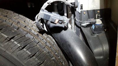

Well I think I figured out the main issue. The body harness on truck side at tailgate has 8 wires but if you follow it about 2 feet later the wIrving harness goes to a connector by the bottom of the hitch and guess what? Only 2 wires (for power tailgate lock) leave that connector and go in the main harness heading towards the cab. Guess Chrysler tricked me on this one. Looks like I will have installed the whole kit up to cab? Any tricks to make the connections at fuse box and in cab?

Here is pic of the connector.

Are you positive that connector runs to the tailgate? There should only be the connector where the tailgate meets the body. You have that one with 8 wires and it then runs to another connector with only two? That's the first I've heard of that. It doesn't match the diagrams I have either (they are for a 1500, though). I wonder why they chose to put another connector there.

Yep, I double check and followed it up to the tailgate connection point. Have been doing some more research tonight and it appears 2500s have this "short wear out" harness which adds this second connection that I took a pic of. Guess I will have to suck it up and wire according to the instructions. Just don't like cutting a grommet to enter cab and splicing in at the BCM. Is it acceptable to use a quality Scotch-Lock or wire tap product for this?
