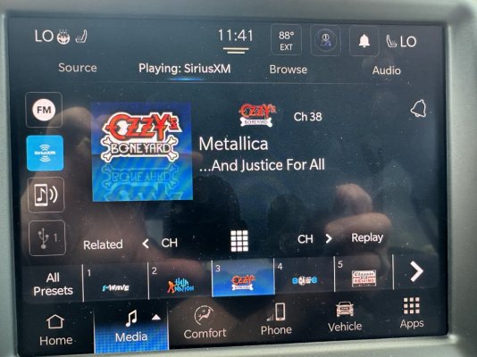

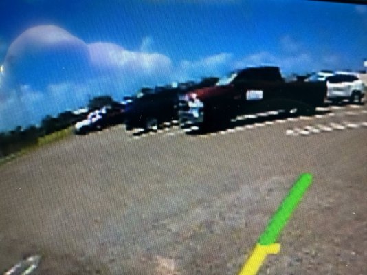

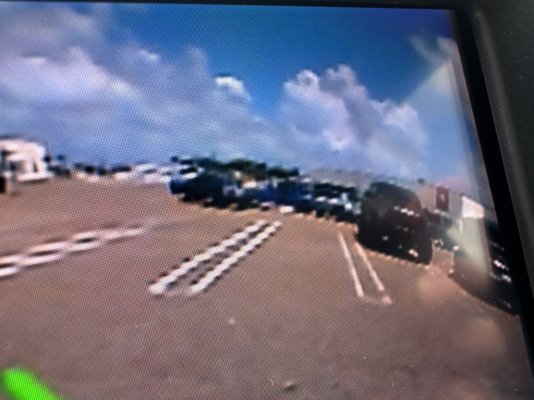

Can you post a picture?
And like I said, the regular radio screen is crystal clear.
Dealership said this is totally normal for the classics , “they are all like this.”

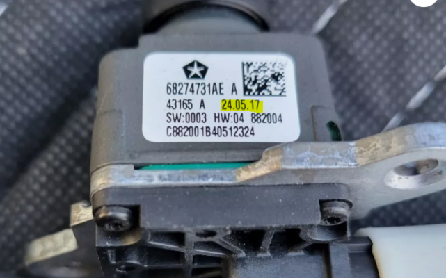

Yikes, that's even worse than the older ones. I wonder if it has to do with the UConnect 5 radio you have? I'd be very interested to see what part number is on your backup camera and it's manufacture date. I'd even be willing to test/swap cameras with you to test different part numbers in different radios. I have seen reports of part number 68274731AE manufactured after Jan 2018 is "supposed" to have a better image quality but have yet to see pictures/specs that prove it.
How do I find the part number?

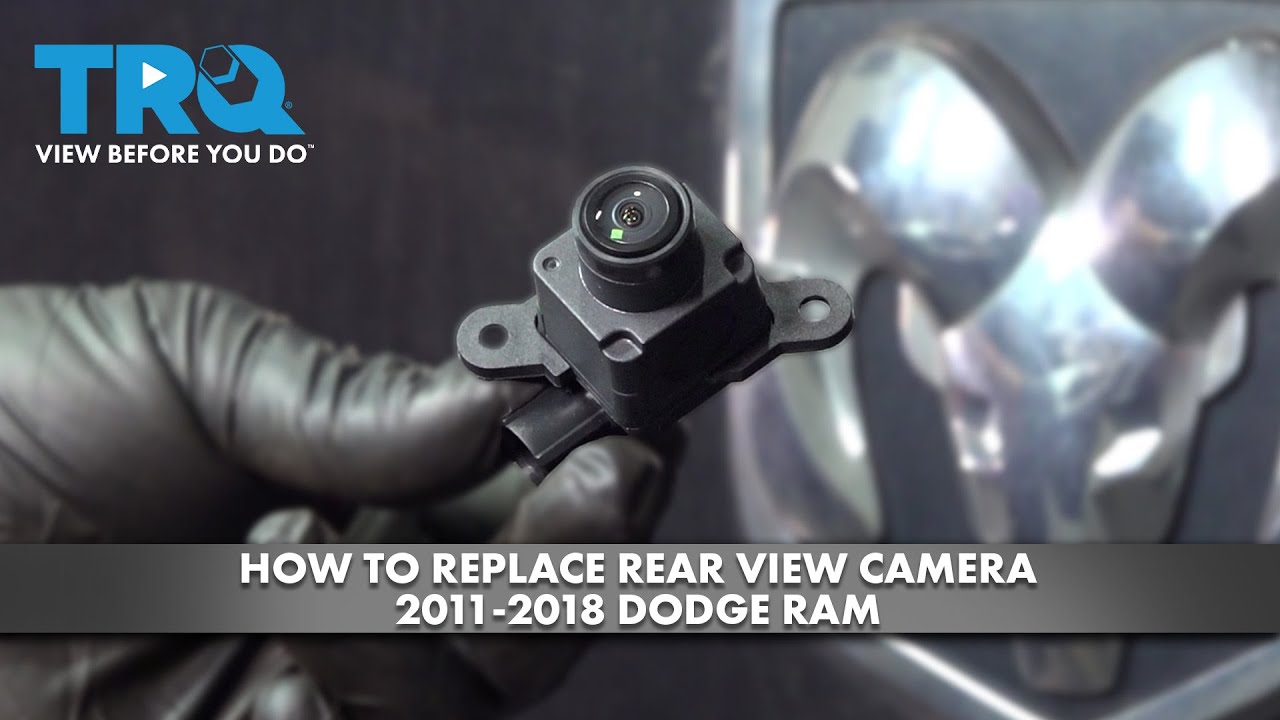

I heard it mentioned that with the 8” connect 5 that because it has a digital input but the older camera is analogue that there may be some connector they had to add that jacks up the image.
This video shows you the details and the P/N and manufacture date will be on the label of the camera itself.
