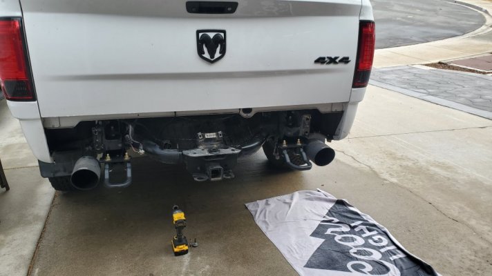

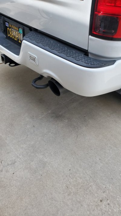

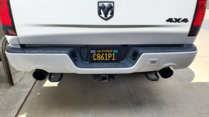

This started with the dreaded Yellow Pole in front of Ralph's Supermarket in Dec 2020. I backed into the polo and it completely bent up the rear bumper. I used a tow strap and a BFH to beat the bumper back to stage that I wasn't 100% ashamed of. I acquired a new (used) bumper from a buddy who owns a junk yard. It was beat up, but it also came with new top plastic and brackets. Since mine was cracked by the pole. It needed a complete to bare metal sanding.....some beating with a hammer etc. But it was free.

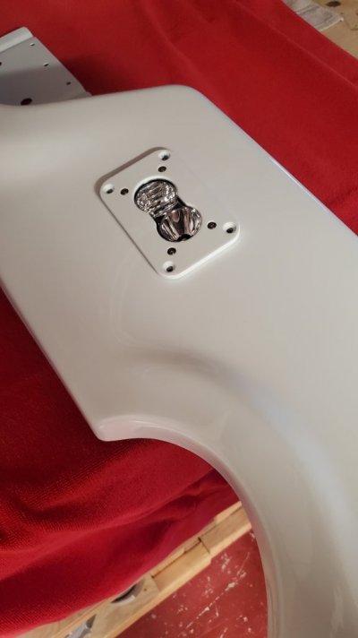

I cut in a flush mount Baja Designs S2 as well before moving onto paint. My brother in law owns a Cafe Racer Motorcycle shop so he painted the bumper and the S2 lighting surround. My only cost was paint. Which was $140 for the white and some clear. Which then left him some extra for a build or 2 down the line.

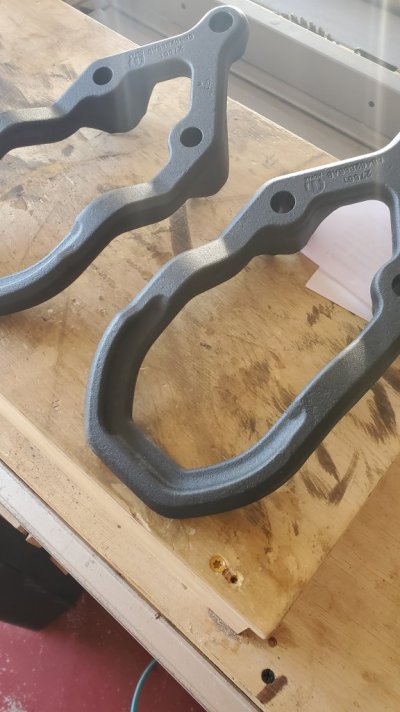

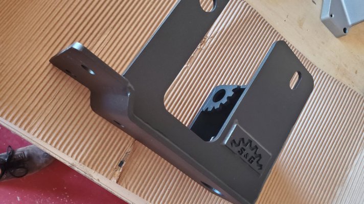

As this all was in the works, I stumbled into Shifts and Grins Fabrications. Who created a bracket that allows the use of TRX Factory Rear Tow Hooks. These are really stout brackets, I am really impressed with the quality of these. They will also add some protection to the rear of the truck. Protecting my 5" Carvin Tips. I did opt for the powdercoating as well. Now these are not cheap. But the truck's been paid off for years, and not liking the rear aftermarket bumpers available I figured the cost was worth it.

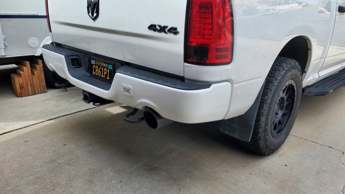

Overall I all I am really happy with the way this turned out. Clean and simple with enough changes a true Ram fan will notice and not stand out.

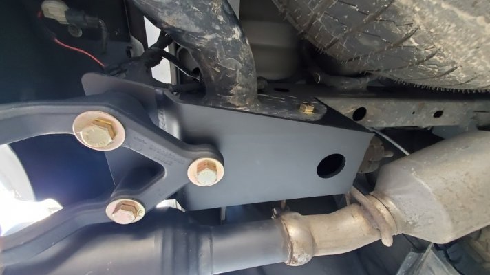

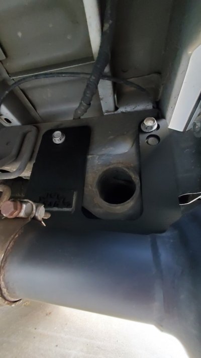

That’s sweet. Can you get some pictures from underneath of those brackets?

Anything that your looking for? It will not be until tomorrow morning but I can add some for you
Trying to see the way they are mounted to the frame. I’m looking at removing my stock bumper in the future and building a custom off-road bumper these look pretty cool
They reuse the 2 bolts from the sides that the hitch uses. Then they reuse one of the bottom bolts the hitch uses. It then comes with an extra bolt that goes in from the center of the truck outwards for extra support. Super easy install. But I'll get some shots for you.

Yea that’s what I’m looking for is the lower and inside. Contemplating designing my bumper to incorporate rear ****** (sna.tch) hooks and the trx hooks would look awesome. Especially if I can swap my front hooks to closed loop rebel hooks

This is the best shot I can get with my phone. The 1st is from the outside of the truck looking to the spare tire. The 2nd is the bottom, inside that bigger hole is the bottom of the hitch with a bolt inside. The 3 gold bolts you see are just the tow hook, which just connects to the bracket.
