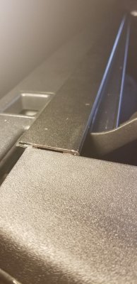

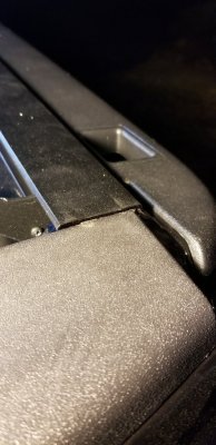

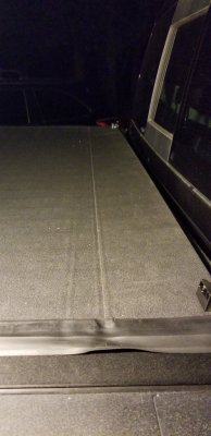

No ram box here a couple pics .. also in the one pic you guys will see that real nasty crease that I saw as I rolled out the cover... I don't know what to say I just feel like the measurements are off by millimeters... the left side doesn't sit completely inside the track as it rolls down... I have installed two of these style covers before one on my dad's Tacoma and one on my buddies Silverado everything was aligned perfectly but for some reason this one is giving me problems... and just to add that if I pull up the rails little bit I can close the tailgate barely but then the cover has a hard time latching on and closing down I got a really bang the crap out of it

hmm, I know on mine I bent the ends up just slightly where the tailgate is. That crease is odd though. You reach out to Bak yet?
