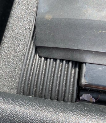

I have the BakFlip MX4 and the factory "gasket seal" which goes across the bed sill under the rear window is of such poor quality that it has already began rotting/oxidizing after 2.5 months. I began a plan last week and swapped it out today in under 20 minutes. Be sure to clean your surface with alcohol very well. It will allow your 3M gasket glue tape to really stick! I made sure I cut the gasket a few inches bigger to tuck it under the my RamBox cover plate. You just use your finger nail to pull the plastic up and slide 2" under it. It will hold your rubber gasket down very securely. This will additionally assist in keeping water out of the bed.
I purchased my gasket made of rubber from Amazon. Its a very high quality made for marine use. The factory gives you foam that degrages very quickly. (There us plenty in the box to run two strips of the rubber gasket as you can see in my picture.
