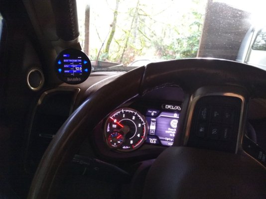

Just installed the Banks iDash pod on my '19 CTD 2500. Haven't driven with it yet, but the installation went smoothly. Now I have to figure out what information to display.
DPF temps, regen cycles, and I got brain drain, what is the temp (sensor) that goes way up when in a Regen cycle, not remember wat called, I monitored that on my Blue Driver on my ED. Any other temps maybe U wanna display that not normally in your Evic.

Boost pressure, Pre-Turbo temp, and DPF EGT. You can gauge how hard your working the truck and see if the truck is regen the DPF.

Thank you all for the suggestions. I don't think my truck has a pre-turbo EGT. Please correct me if I am wrong.
Nope not wrong, (force of habit typing pre-turbo, my bad).
Cummins EGT sensors:
EGT1 is post-turbo
EGT2 is afy the DOC
EGT3 is after the DPF
EGT4 is the center of the SCR
EGT5 is the outlet of the SCR
