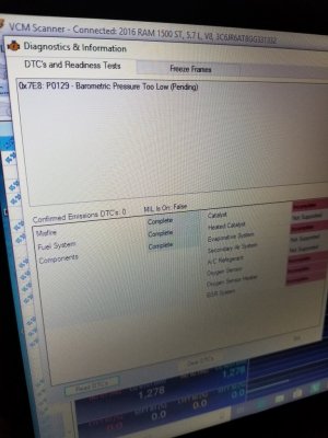

Trying to get my built engine to fire up. Throwing this code. Any help is appreciated.

Is it not starting or throws that code after it’s running?
What have you done to the engine.
P0129 is usually a faulty map sensor or an issue with the 5 volt supply.
