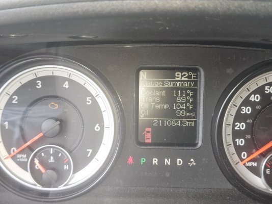

Ok guys,
Just started up the truck to go home and got a 'ding' and check engine light, notice my oil pressure was reading 99 psi.
Code reader shows a P0520.
I have no mechanical gauge to verify oil pressure, but truck does not seem to be running badly, no ticking etc. or knocking.
With 211k miles, is it my time for an oil pressure switch?
Part # 5149062AB approx $80 @ dealer
Oh, and it shows 99 psi with engine off.....lol

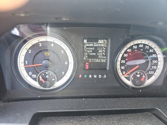

Tempted just to drive it home, but not gonna chance it. Funny thing, I went out for lunch, pressure reading was fine.

That is a circuit code, not a pressure out of range code. 99psi is probably the max value the PCM can read, meaning that the sensor is completely shorted to ground internally. (or the signal wire is shorted to ground).
Ether the sensor is bad, the wiring is bad or the connector is bad.
Probably the sensor.
