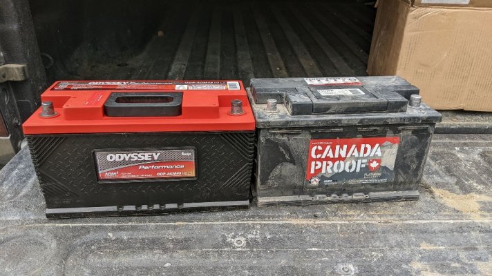

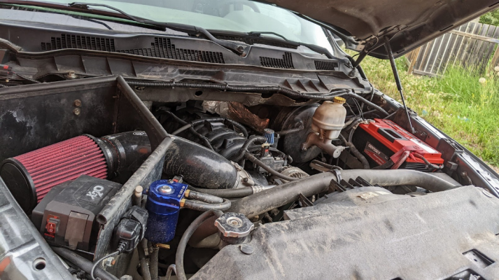

When it does come time to change, that Odyssey H8 looks interesting. Thanks @DILLIGAF. If prices keep going up, might have to sell a kidney.....lol.
DILLIGAF
Canadian Forces
May 28, 2016
5,730
12,210
Canada
Yeah I hear ya, But the cheaper batteries dont seem to last with my winch setup and our -50 winters.
Ill give a honest opinion after a year and next time I go play in the mud. Im not one to hold back when something sucks. even if it cost an arm and a leg!..lol...
But the fact an H8 fits in our trays with minor trimming is a big bonus. Costco has great deal on AGM H8s as well and the exchange policy at Costco cant be beat !
