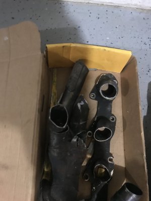

If you make a poor decision to buy them and the passenger side fails, I have one on the shelf. Here is my driver side.
4014 chrome, poor warranty claims, would not recommend.
