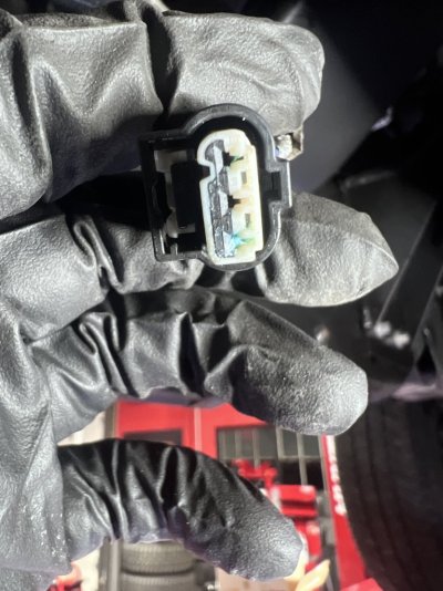

Yeah the scanner can do that. But nothing in the driver's door. Can get the passenger to work but no driver again. Seriously running out of ideas.
Have you looked at any diagrams to see if the door itself has a ground? I've never looked but it's possible?

Tipm can cause similar issues with one thing then all the sudden you’re in a no start situation. It will come down to testing every circuit and tracing wires. A lot of the time it’s one wire broke at a connector

Yeah, it seems like it's isolated to the driver door harness somehow. Everything else connected to the BCM works. So either a wire or a connector is messed up. Now I'm just trying to find the harness for sale. Dealer wants like 500 for it.
Harness may not fix it. Throwing parts at it is not diagnosing. Getting a wiring diagram and back probes is a lot less expensive. Can bus errors could be in a tail light causing weird stuff. I had one last week that was giving transmission errors and glow plug errors. It turned out to be a corroded connector at the rear of the truck
