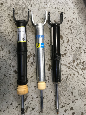

That will be an interesting test. 5th gen can run our struts they just wouldnt get the same lift height mostly cause the spring seat is lower in our case.
4th gen on the left, 5100 in the middle, 5th gen on the right with the higher seat.
From pics/documentation we have, 5100/6112 4th gen are same lengh as stock 4th gen struts. mostly 21.40 extended, 15.12" compressed, extended travel 4th gen is 22.5-23" tops, 16.8 compressed and you get that with Falcon (if i remember the version with the adjusters), King 2.5 and Fox 2.5, possibly Radflo and Icon (haven't been able to validate)
Fox makes two version of Coilovers for the 5th gen RAM, a standard and an extended version.
Don't know which of the two is BDS using in this kit, we could benefit from the standard version, 23.28" extended, 17.78" compressed. however you'll be loosing at extra 1" uptravel as opposed to the extended travel versions for 4th gen, but gaining an extra 1/4 to 3/4 of and inch downtravel.
Fox 2.5 extended travel are 24" extended, 17.78 compressed and i'd think too long for our CV's/tie rods etc at full droop.
