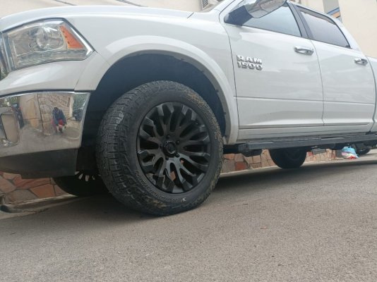

not a clue about the kits your talking about, but i think that truck, with those wheels would look better with more sidewall on the tire and a lift
i think leaving the 33s on an lift it, it will look silly (meaning, out of proportion)

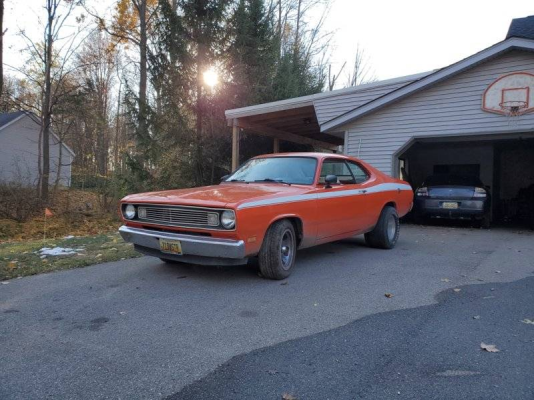

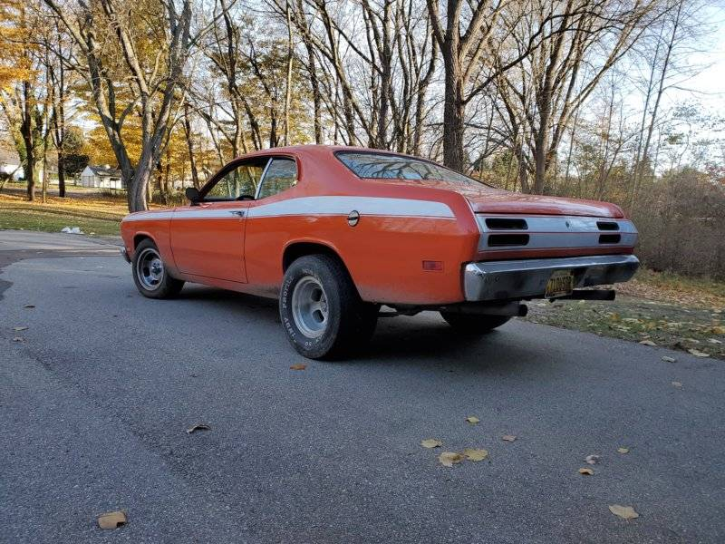

Most of my stuff only gets modded for a purpose, not for looks
Even the sky skyjackers on my duster (the epitome of cool) were originally installed to clear the N50s
The guy states he doesn't go off road with it,right in his first post,so it's a pavement princess,and he's doing it strictly for looks,and in that case a body lift accomplishes the look he wants,and is probably the way he should go.
Did you also have 6" of shackles hanging under the rear bumper to,lol. I was never much of a fan of air shocks or shackles,i always had the springs re-arched when i lifted the back end ;) :waytogo: No shackles or air shocks under my old 68Z,lol.

Car was a show queen,that ended up in a couple hotrod mags in the early 80's,and also made a pile of track passes,so the rake was set up to get looks,and also work at the track. Car ran high 10's in the early 80's,which is slow now,but back then a street car running 10.70's was fast as hell,lol. Your old Duster would of done nothing but spin,with that stance,lol.
You mean like this ?
I've had the duster at the track once, but I kept outrunning my fuel supply
(My 1/8 speed was higher then my 1/4)
I think the jumper hose between the steel fuel line and the pump was collapsing, but I haven't been back since I fixed it

I don't want to make changes just for the appearance but also to improve the driving quality and the Bilsteins didn't turn out to be great. The streets of my city are full of potholes and it feels like offroading!
I think that with the adjustable fox 2.5 it should change the ride for the better and with a 4" kit I won't be too tall and the truck should be very stable.
Now with my current configuration I have pitching problems that bother me a lot; My mechanic claims that a Ram is too heavy and needs shock absorbers with a wider and more resistant body.
I purchased the zone BL but I no longer mounted it because they made me think about how it could damage the chassis in the long term as it is something that comes between the chassis and the bodywork and therefore I left it still sealed in its package !

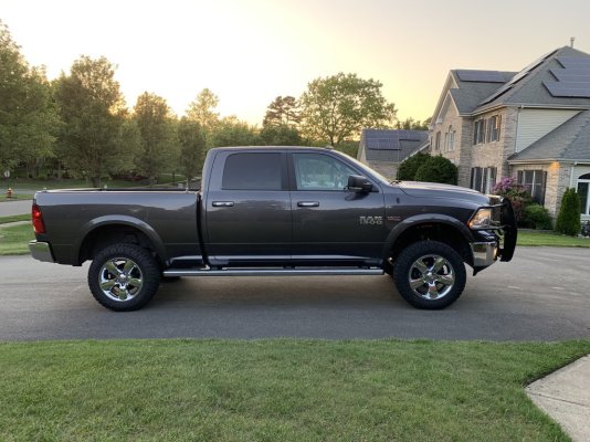

This is mine on stock tires and rims. Zone 6" with their UCA's. Front is 5", rear is 3". About 1" of rake.
Drives better then stock and looks great IMHO.
I was in the same boat you're in with lifts. I.E. brands, height, shocks, additional accessories. I have a multi page thread in here if you want to take a look at that. I don't know how to attach it though.
@Quick_Shifter did the install and answered my seemingly endless amount of questions and bought the package from @Nick@GotExhaust.
Good luck with your search.
