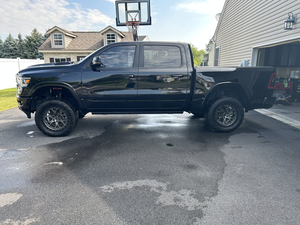

Here is my 2021 with the BDS 4” kit. Installed by AK Trucks in PA. The only guy I would trust to do something like this to my truck. The ride is awesome.

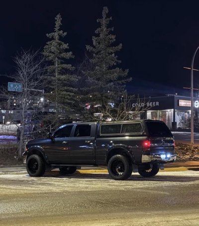

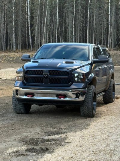

I’m running the Zone 4” lift with Bilstein 5100 series all the way around. I love it it so far. The only thing I need to look at, is possibly adding extended cvs to correct the choppy parking lot turning.
Had to set the front Bilsteins to 0.75 to knock the rake out.

Adamcr68
Mar 28, 2020
820
1,546
Lorton VA
Hemifever 5.7
Stance is perfect IMO. Looks great!
