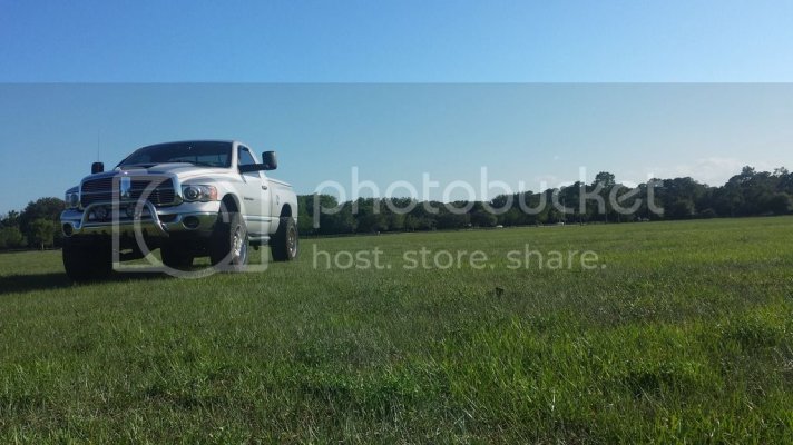

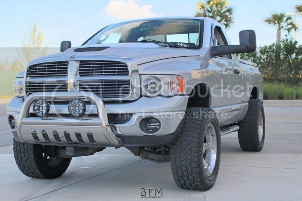

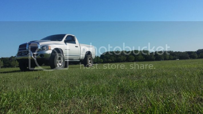

so i bought a rough country 6 inch lift kit and got used to it too quickly and it didnt look tall enough. so i called around and rough country said that i cannot put a coil spacer on the kit and align it. well i went ahead and put a 1.5 coil spacer on top of the 6 inch lift kit and got it fully aligned no problem. a full 10.5 of wheel gap. also i added 1.5 inch wheel spacers to the truck as well, some minor trimming and it was all good!!
now i have a 7.5 inch lift on 35s
after the coil spacers and the wheel spacers (i didnt get to do the 4 inch rear block yet so its rocking a cali lean a little bit)
before the coil spacers and wheel spacers

As long as it's safe, why not? How's your gas mileage now? And where do I get the receiver hitch for the front bumper???
Auto anything has it from a company called curt it's a very easy install. And gas mileage is relatively the same honestly lol

Very nice looking truck! I like the hitch in the front, was contemplating doing that to mine. What tires are you running?

Thanks man I appreciate it. Auto anything has it for a decent price it's from Curt hitches. I am running 35x12.50r20 toyo open country at extremes. I am highly considering doing baja fenders (ramrunner) with 36x15.5r20 mickey thompsons
