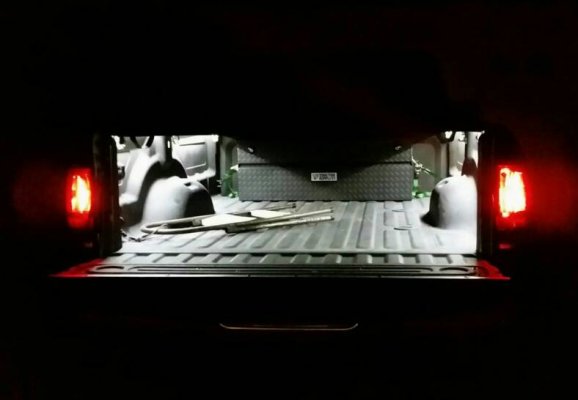

As for the more lighting if/when you get you a cap:
I used LED tape lights from superbrightleds.com and added a switch off of the power for the existing light in the cap.

That looks bright, do you recall which strip you bought from superbrightleds.com?
These should be the ones: WFLS-NW300-WHT
https://www.superbrightleds.com/mor...with-18-smds-per-ft-1-chip-smd-led-3528/1466/
They are the 3528 LED SMDs rated for automotive use and IP65 waterproof.
Even though the 5050 LED SMDs are brighter, the 3528s light up the back like daylight. I used the same ones under the sides in the bed of my buddies truck for lighting under his tonneau cover/fifth wheel.

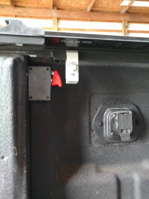

Hey what did you tap into and where ? I am about to this to my truck Just trying to figure out the easiest spot to get the 12v
In my truck's cap there was already a fuse block for existing light. It is tapped off of the +12V from trailer 7 pin. I used the same +12V from the trailer 7 pin in my buddies 2500 for the under bed rail lighting. I did add a small 2" x 3" enclosure with a 5 amp fuse and an On/Off switch for the LEDs(see Pic).
Clean the surface really good with isopropyl alcohol (I always have 99.9% pure electronics cleaner) rubbing alcohol. The LED strips have been on both trucks for at least 3 years with no issues of peeling off.IMG_20161016_154627986.jpg

I stripped off some of the insulation and soldered to the truck wiring without cutting them. Then sealed the connections with liquid "electrical tape" and then wrapped the all the wires back up with regular electrical tape.
If you don't want to tap directly into the wires going to the back of the plug, buy one of these:
CURT 56584 https://www.amazon.com/dp/B007EA6WQU/
This will give wiring hook up for a tailgate LED bar w/reverse if you were thinking of adding one also.
