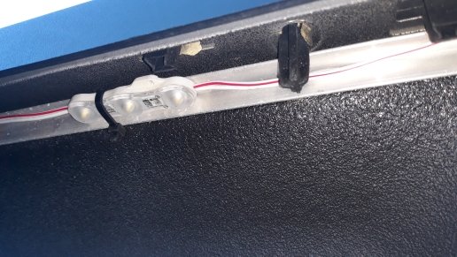

Blue Mule
I dont find the same seller in ebay. Anyway I have some left. I buy a lot that time. If you like I can sell you 20 pieces, 10 by side.

I have a 2014 without factory bed lighting. How are you all wiring it etc?
bryce88
Jun 20, 2018
330
341
Utah
I wired mine directly to the battery and ran a switch to the bed up through behind the tail light. I like being able to switch them on apart from the cargo lights without fiddling with the key fob. And I can leave them on as long as I want.

Yes, they come on with the key fob or use the cargo light switch on the dash for extended time
This is why I connect mines like that. It go on with the key when you open the car and with the factory switch in the dash. I dont see any better way.
BTW guys. I have Leds modules that I can offer for 27$ shipped for 20 pieces. 10 for each side. They are brighter than any you can find.

I added a red led light strip 2 years ago and tied them into my factory bed lights. The factory lights are good for the rear of the bed, not so much up front. I ran one strip all the way around. The front has been beaten up from hauling things, but it still works for the most part.
