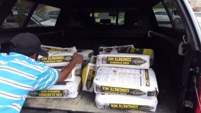

Gotta go pick up 22 80 lb bags of concrete at HD today... Driving on flat paved roads .. am I gonna damage anything?
Left out a lot of info. Year, engine, bed length, cab config. 2018 Ram 1500's can carry between 1380 & 1800+ based on model details. Older trucks are generally a little less each year. Everybody does what your talking about once in a while. Watch out for railroad tracks, washboard roads, way off-camber turns, etc. & take it easy. Also, remember if you're in collision and you're overweight, you're wrong even if everything else is good; especially if injuries occur. Good luck.

If you can rent a small trailer its much easier on your truck. If you can't.. stack the bags between the cab & the rear axle to help keep the weight centered between the axles best as possible. Some weight could even be put on the back cab floor. Stock 4th gen Good Year Wrangler SRAs had a max load capacity of 2,601 each at 39 psi not the max inflation of 44 psi. (a common misconception)
So if the truck and you weigh 6k and you add 1,760 pounds you are at 7,760 far from the combined 10,400 of tires if weight were equally distributed. That said you don't want to be anywhere near that. Even combined max axle is only 7,800 again if weight is equally distributed. 7,800 is more of a hard number that you don't want to exceed as you are at the limits of your brakes and suspension even with helper bags.
Not judging or preaching doom as my tile load was 8k just saying.
