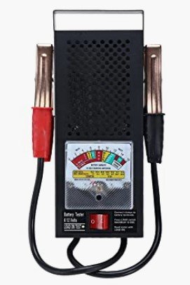

Load test your battery with a toaster-style battery load tester like this $18 unti from HarbourFreight. Don't be fooled by a digital tester used at most parts store, they're prone to false positives.

post #10: I have that exact batter tester. It shows a lil passed 12volts.
