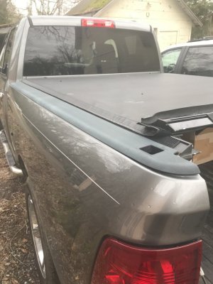

hey guys, I want to paint these things black again to look fresh. How do these come off and is there a big risk of them breaking while doing so?

yes they come off just take your time start at one end as the rail is lifted you will see the snap in clips just push in with screw driver again do it slow just dont pull them up or the clips will break

Before pulling them and painting them, try Wire-New or something. See if you can get the color back without all the trouble

You can get all new pieces for $150. Just changed mine today. Unfortunately i broke all of mine trying to get them off but i had new ones ready to go one.

And much easier to just tape them off and paint them where they are if just faded. As long as it isn't windy or in the garage you can control the overspray and thin poly is cheap.
