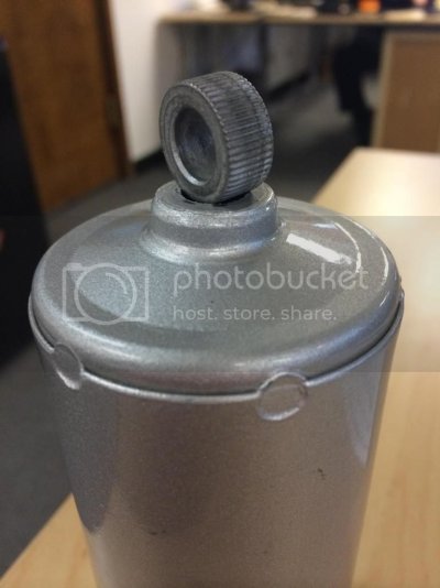

I saw this somewhere before, but I couldn't find it again. I know others have had the same issue with the front shock bushing sliding thru. Any solutions? Im sure someone contacted Belltech...did they offer any help?
Worst part is I bought the set and it has been on less that 7 months and 5k miles.

Pull the sleeve off the shock, and inside there is a small washer, with a long handled screwdrievr, snap off that small wsher inside the boot. They say that will fix the walking issue off the rubber end.

When you say "they" is that Belltech or someone that has figured it out on their own?

Yep, what graygoose said is what BellTech recommended to me when that happened.
