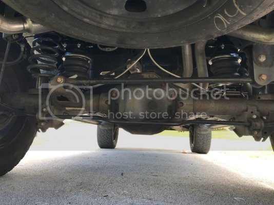

Airlift 5000 on 7” maxtrac lift need 1” spacer on top of bags I don’t tow much just a couple of skis and gear hated the lean so I put these in but I do haul more in the bed for work and they work great less lean depending on psi but most importantly I keep my steering

I installed the Timber Grove air springs/bags. They are top quality, easy install and the owner gives outstanding service. I added Air Lift WirelessOne Compressor System - # 25870. It comes with a wireless remote that allows me to increase or decrease PSI from inside the cab.
Same here....
