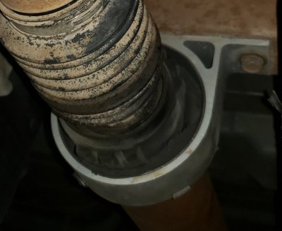

On my '12 3500 4wd (stock suspension/driveline), I was getting a noise at speed that was getting more annoying. Looking into it, I found it was the center support bearing on the driveshaft. It wasn't seized l and the rubber was fine, just noisy when spinning. With 110k miles, not a big deal, just a wear item. I got one from O'Reily Auto and replaced it. Noise was gone and I was happy. No vibrations or other issues before or after.
Less than 500 miles later, we took a trip into the foothills and started hearing a noise about 15 miles from home. Sure enough, the rubber had broken out. I drove it home about 30mph. I'm not sure if bearing is actually seized or not, but the rubber has definitely torn loose.
It's an easy enough fix, but what brand of bearing should I get? Reliability is more important than low cost for me.
